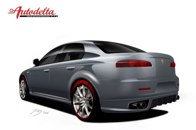

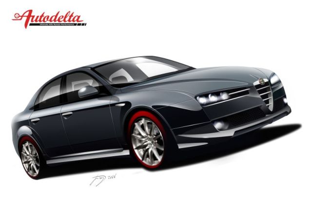

“Overall we feel the cars are more then capable to fulfil most drivers’ demands but of course we have gone a further step to satisfy the most demanding of owners and for the most extreme usage of the cars,” says Jano. This has involved progressive all round dynamic development of the car to create a cutting-edge, envelope-pushing sports saloon. The Alfa 159 is based on the same architecture as the Brera, allowing technology applied on the Brera J5 3.2 C to form the underlying basis of the upgrade. A fully adjustable coil over suspension set up allows for height adjustment as well as rebound adjustment to enable the driver to fine tune the car for any occasion. Up-rated perforated brake discs and special compound pads improve the braking capability, while an entirely new aerodynamic package will present a distinct new styling direction.

85_Autodelta_J4_22C
48_Autodelta_J4_22C_1

Na ja, das Gewicht passt ja beim 2.2er besser als beim 3.2er ... und dazu noch das Autodelta Spoilerkit (was nun wirklich nicht schlecht aussieht!) ... mhhh, lecker!
Beitrag vom 12.06.2008 - 17:49
Der sieht doch sehr sehr Schick aus grosses Lachen
Beitrag vom 12.06.2008 - 19:41
Sehr schick, ist halt das italienische Feingefühl für Design. good job

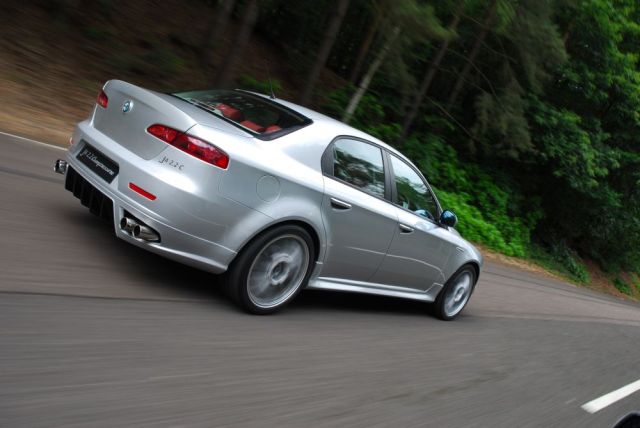

That's it:
63_Autodelta_J4_22C
23_Autodelta_J4_22C_1
53_Autodelta_J4_22C_2
13_Autodelta_J4_22C_3

also das heck gefällt mir gar nicht... sieht mir zu sehr nach golf-plastik-tuning aus...
